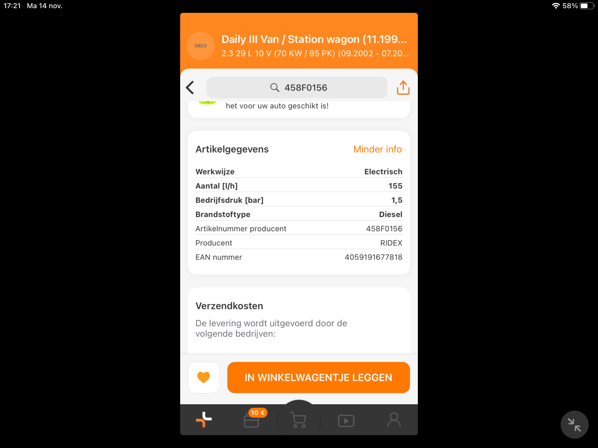

Re: engine runs, but pops out of the exhaust
Hallo fellow readers,
An upgrade of my Yamaha turbo vicissitudes
Checked everything today: the fuel lines, see if it can kink somewhere when the engine is warm. All tube springs were fitted except at the tube to the fuel pump. This has now been installed. Fuel filter leaked, so installed a new one. Started before the garage, started immediately. Let it idle for a while, then hit the road again. This time the engine stops after 1.6 km, and after 10 waits started with the gas fully open. The engine started again and struggled to stay on. Back to the garage drove about 1.2 km. For the garage it continued to run, let it run for another 15 minutes. The engine did that without any problems. It's getting a bit dull, the popping is over now. But a ride with it is daring. I think the engine is getting too much fuel. The spark plugs checked, spark plug 1 to 3 light brown and spark plug 4 pitch black. The spark plugs are dry. I checked the oil from Saturday's ride. There was fuel in the oil, it is now out and I have now put cheap oil in it to flush. After today's 2 km no fuel entered the crankcase. The oil level has remained the same. The only thing I can think of is to adjust the carburettors and hope this is the issue. But I doubt that's it.
Hallo Mitleser,
Ein Upgrade meiner Yamaha Turbo Wechselfälle
Heute alles gecheckt: die Benzinleitungen, mal schauen ob es bei warmem Motor irgendwo knicken kann. Bis auf das Rohr zur Kraftstoffpumpe waren alle Rohrfedern verbaut. Diese wurde nun installiert. Kraftstofffilter undicht, also einen neuen eingebaut. Vor der Garage gestartet, sofort gestartet. Lassen Sie es eine Weile im Leerlauf laufen und fahren Sie dann wieder auf die Straße. Diesmal geht der Motor nach 1,6 km aus und nach 10 Wartezeiten mit voll geöffnetem Gas an. Der Motor sprang wieder an und kämpfte darum, anzuhalten. Zurück zur Werkstatt fuhren wir ca. 1,2 km. Für die Werkstatt lief er weiter, noch 15 Minuten laufen lassen. Das hat der Motor ohne Probleme gemacht. Es wird ein bisschen langweilig, das Popping ist jetzt vorbei. Aber eine Fahrt damit ist gewagt. Ich denke der Motor bekommt zu wenig Sprit. Die Zündkerzen geprüft, Zündkerze 1 bis 3 hellbraun und Zündkerze 4 pechschwarz. Die Zündkerzen sind trocken. Ich habe das Öl von der Fahrt am Samstag überprüft. Es war Sprit im Öl, jetzt ist es raus und ich habe jetzt billiges Öl zum Spülen rein getan. Nach den heutigen 2 km ist kein Sprit ins Kurbelgehäuse gekommen. Der Ölstand ist gleich geblieben. Das einzige, was mir einfällt, ist, die Vergaser einzustellen und zu hoffen, dass dies das Problem ist. Aber ich bezweifle, dass es das ist.
The specifications of the fuel pump that I have installed.
Die Spezifikationen der Kraftstoffpumpe, die ich installiert habe.
Cheers, Dirk
